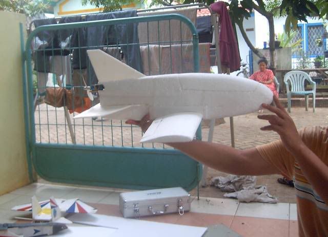

Trims Pak Prabowo,
Setelah lihat article dari Bapak, semakin ngeri deh, apa lagi sebelumnya dapat dari Pak Jedx tentang karateristik dari pesawat modelnya sbb:
Flight characteristics
Fast. This is not a beginner aircraft. We recommend
that you be an intermediate to expert flyer.
Take off from the ground. Do not throw.
We have never hand launched. Check for tip stalls
on the first flight up high. This plane has little wing
area and does not fly like a trainer. We have added
washout to the wing tips to help prevent tip stalls.
The short wing version will fly and land faster than
the long wing version. Land with plenty of forward
speed on your first landings and fly it to the ground
until you get used to the flight characteristics. Enjoy,
and fly safe!
Moga2x dapat terbang.
