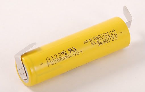

Waduh sodara2 sekalian, liat kodenya itu batere yg ada tulisan " 18650", bisa dipastikan itu batere adalah batere "A123", bukan Li-Ion sodara2..
ini sama kan ?.
ini keterangannya
Produced by Enerland/A123 Systems
Nominal Capacity & Voltage: 1.1Ah, 3.3v
Recommended standard charge method: 1.5A to 3.6v CCCV, 45min
Recommended fast charge current: 5A to 3.6v CCCV, 15min
Max continuous discharge: 30A
Pulse discharge at 10sec: 65A
Cycle life at 10C discharge, 100% DOD: Over 1,000 cycles
Recommended charge/cutoff voltage: 3.5v to 2v
Operating temp: -30 ~ +60degC
Cell Weight: 39g
harga diluar perunit = US $13.50
