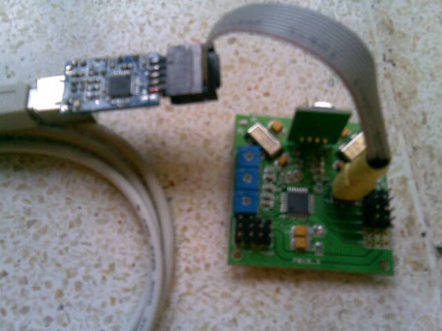

:ide :ide :ide atmega 168 AU dah dapat 2 ekor...tgal ganti HBK board dr 48 ke 168 :mwr :ide

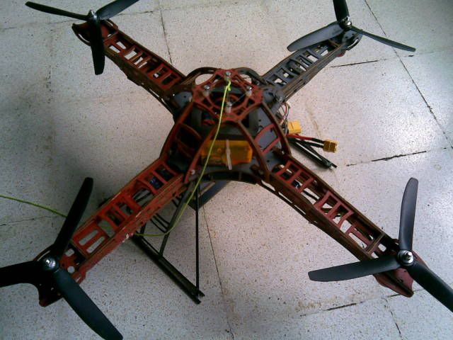

:tlt :tlt :tlt FINAL.... :tlt :tlt :tlt
:mwr :shy :shy :ide

sip..udah terbang om? :plk :plk

rachmatjeny wrote:sip..udah terbang om? :plk :plk
:ha3 :ha3 :ha3 msih bru blajar terbang SUHU lihat itu msih ad talinya :ha3 :ha3 :ha3

:tlt :tlt :tlt ternYata terbangnya .....Ueanak..... :ha3 :ha3 :ha3 ....... :mwr ngk nyesel...dibelain lembur 3 malam...kemarin hari.... :ha3 :ha3 :ha3 segera diuplod pideonya..... :ok

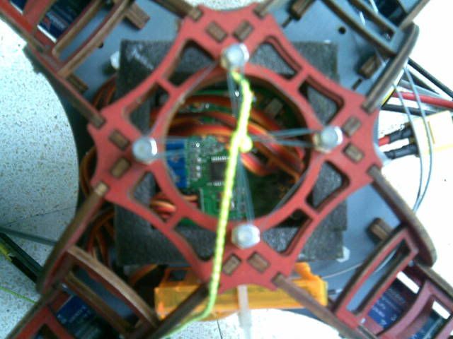

spek.... :tlt :tlt :tlt
motor 800 kv x 4
prop 3 blade gws 8x5
esc 30A hk x4
hk frame ... di perkuat dikuas sma VERNIS
batt 3s 2800 20c zippy
hk board q copter
lipo buzzer 3s x1
conektor perempatan.....CUSTOM.....
setting pot gain gyro
yaw 80%
pitch 73%
roll 73%
sett tx expo
rud = 70%
elev = 45%
ail = 45 %

tapi masih goyang2 ya om? padahal itu indoor loh,..
perlu diperdalam lagi om.... LANJUTKAN!

:tlt :tlt :tlt klo out dor malah anteng...... :flu :flu :flu :flu knapa ya..... :flu :flu :pyg
