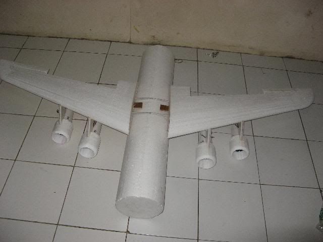

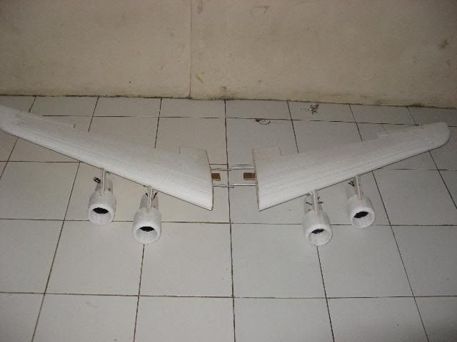

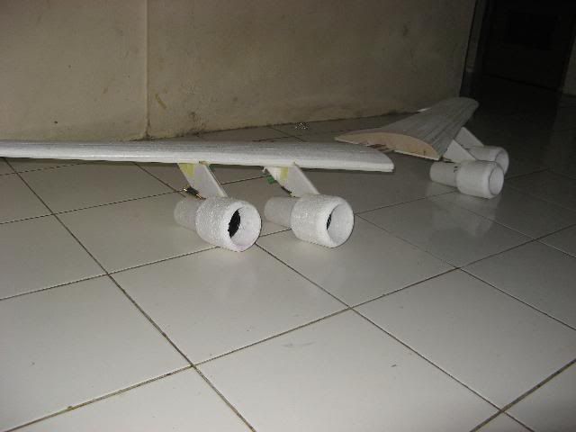

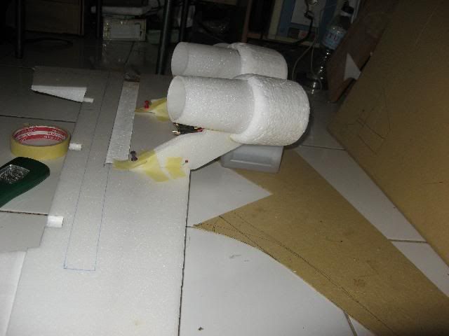

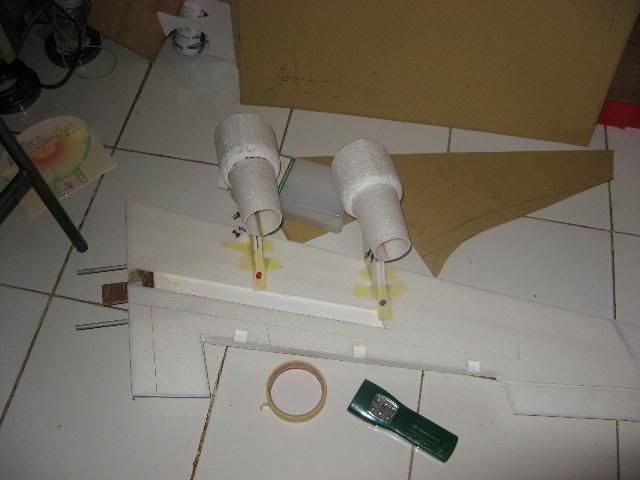

nambah..
lem dudukan
penampakan wing + edf
kalo dipasang ama "guling"nya kira2gini
