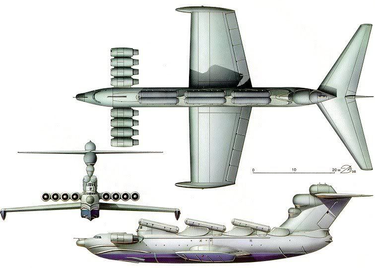

Ekranoplane "LUN", monster setengah kapal setengah pesawat
Designer : Central Design Bureau "TsKB po SPK" n.a. R.E.Alekseyev
Builder : Shipbuilding Plant "Volga", Nizhni Novgorod, Russia
Take off weight : 400 tons (882,000 lbs)
Length : 73.8 m (240 ft)
Span : 44.0 m (144 ft)
Height : 19.2 m (65 ft)
Speed of motion:
* at cruise flight
450-550 km/h (243-297 kts)
* in displacement position
20-100 km/h (10.8-54 kts)
Range of flight : 3,000 km (1,620 nm)
Range in displacement position : 400 km (216 nm)
Sea endurance : 5 days
Cruise altitude : 1-5 m (3.3 - 16 ft)
Altitude of flight at search : 500 m (1,640 ft)
Max altitude of flight : 7500 m (24,600 ft)
Max waves height:
* at take off and landing
2.5-3.5 m (8.2-11.5 ft)
* at flight
unlimited
Powerplant:
eight NK-87 turbofans of 13 tons (28,660 lbs) trust each
Crew 9 plus 19 rescuer
Max number of saved people 150-500 (among them 70 - cot case)

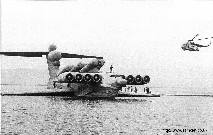

gile... serem juga ya...
jadi penasaran... ini sama gak ya?
lagi...
KBSantoso
Posts: 1444
Joined: 09 May 2010, 21:56
Re: Monster laut Kaspia
Post by KBSantoso »
@RJ : sama Om, ya itu pesawatnya. Saking misteriusnya baru diekspos setelah puluhan tahun.

:-k :-k :-k
guede banget mesinnya buanyak banget
