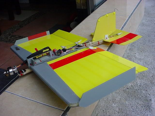

here is my version,.............
with pictures only,.....

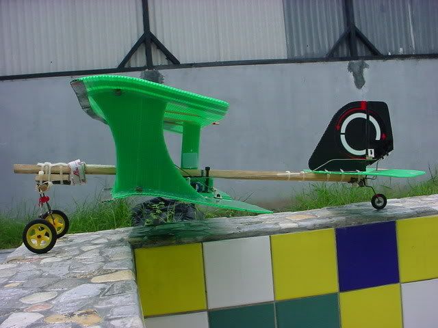

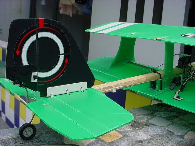

Front View
Side View
My dimension in cm

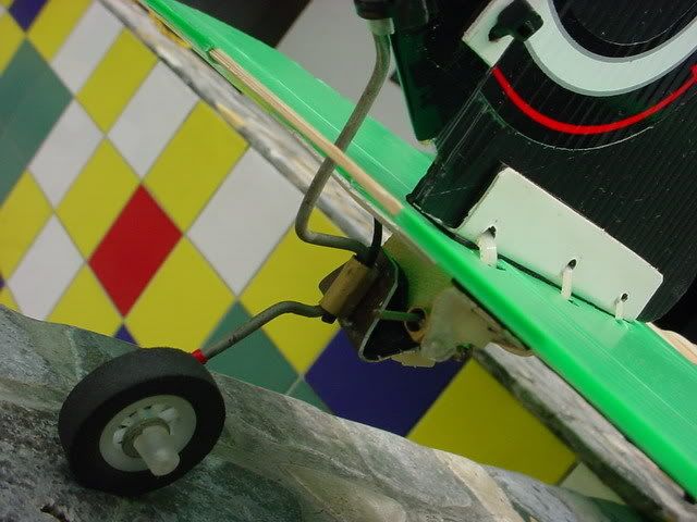

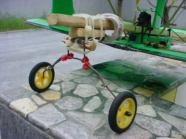

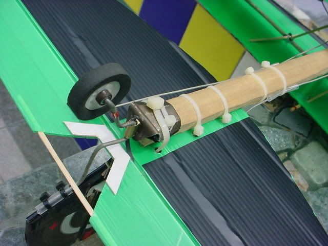

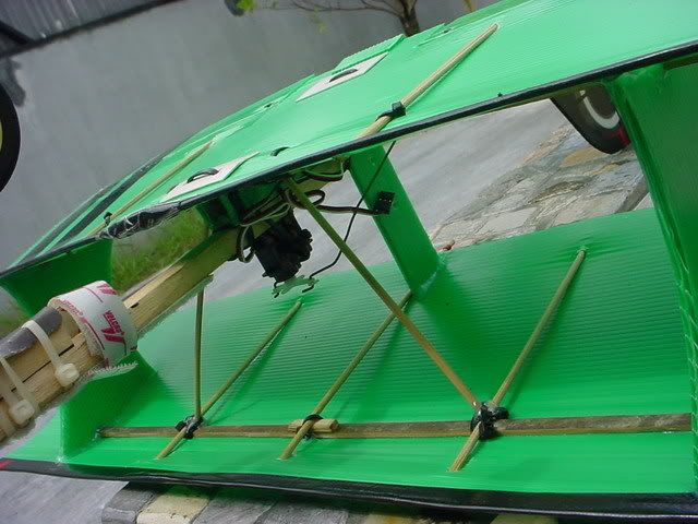

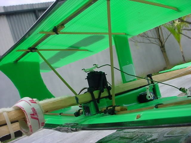

Using a lot of zipties and some hot glue,
Using Zips makes some joint with bamboo skewer more easy
Using some alumunium,....
Cheers.
PS: Motor was mounting like this,.....(using zipties and alumunium too)
